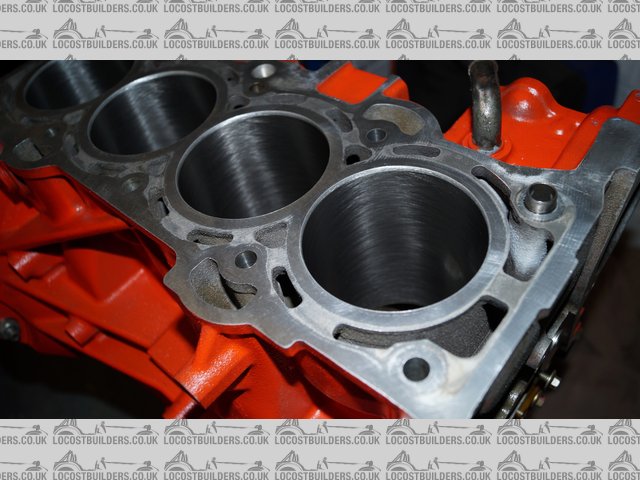

Ok, so I got the engine block back from the engine builders (Connaught Competition Engines) and was really pleased with their work. They also balanced
the crank, flywheel and clutch cover as well as the pistons and rods.

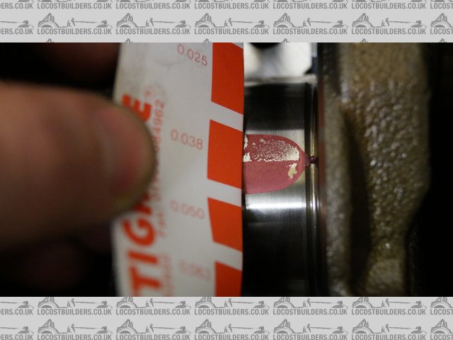

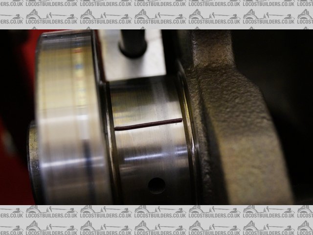

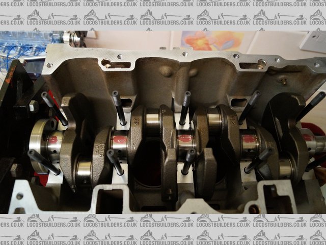

With the crank I decided to check the bearing clearances with plastigauge. Im using cosworth main bearings and ARP main studs. The first time I tried
plastigauge I ended up at about 0.050mm across the 5 bearings which is a bit out (meant to be 0.019 to 0.035). Turned out I didn't torque the
nuts correctly AND my garage is 3 degrees celcius, so the wax of the plastigauge didn't spread very well, in fact it kind of cracked mostly. So
second time with a warmer room, tighter torque setting (burton says 70lbs/ft as I didn't use the ARP lube) and I got a better result.
A little on the high end of tolerance but should be ok.

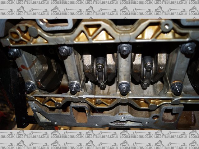

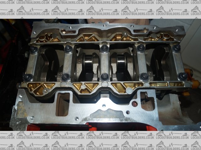

So today I decided to finish the block off. First thing was to finish the crankshaft and torque it down properly with the ArP studs and nuts. It took
ages getting the bearings in the right locations, with the oil hole correctly lined up with the crank oil galley. Once torqued down I turned the crank
by hand and it felt pretty smooth.

Also worth noting is the crank cradle needs to be perfectly aligned with the block, I planned on making a tool but the surface of the cradle was awash
with casting lumps so I used a rule on the small section that was actually machined.

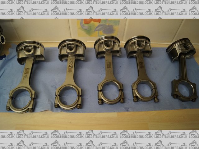

Next came the forged rods and pistons. I used cosworth pistons and K1 rods. The quality are outstanding!! Although it was a real pig getting the
gudgeon pin retainers in. Took a lot longer and more effort than expected. Connaught Competition Engines also balanced the pistons and rods as well as
the crank, flywheel and clutch cover.
Then I installed them into the newly honed block. Connaught Competition Engines did the honing and they also gapped my rings too!

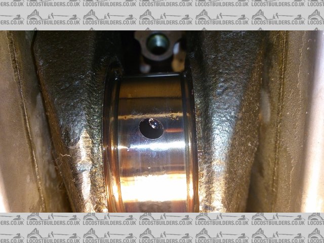

Then I realised I hadn't put the ARP lubricant on one of the rods so I removed it and im glad I did. The oil journal in the crank had a raised
lip and was scoring the bearing! Thankfully I spotted it before much damage was done. So I removed all the others and I could feel a lip on all of
them with my fingernail. You can see in the following photo that there is a piece of the bearing material shaved into the oil way.
I was rather pissed off, and confused as this was a crank that I removed myself and the bearings that is was then using were fine. Very odd. In the
end I used a very fine small piece of wet and dry to just remove the lips of the holes. Hopefully it'll be ok now. It all turns over nicely
Next on the list is the cylinder head and the oil pump. Ill do the oil pump next and the head in a weeks time as I have ran out of money!

Those oil passages want a damn good chamfer around them If it's not too late I'd take the crank out and carefully cut a 0.5 to 1mm
chamfer on them all either with a dremel (be v. careful!) or a needle file. They don't need to be that neat, but break that sharp edge smoothly.
Sharp edges on oil passages are a great crack propagation point on a crank...

| posted on 23/1/15 at 03:35 PM |
Yeah I used my cheapo dremel and made a little chamfer. Fingers crossed it's Ok.
