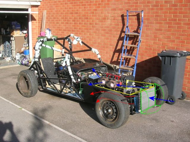

loggyboy
| posted on 22/1/15 at 09:20 AM |
My plan is to split the bay in two with some sheilding, having hot and cool areas, no idea if it will work, but thats the plan:
  Striker Airflow
Mistral Motorsport
