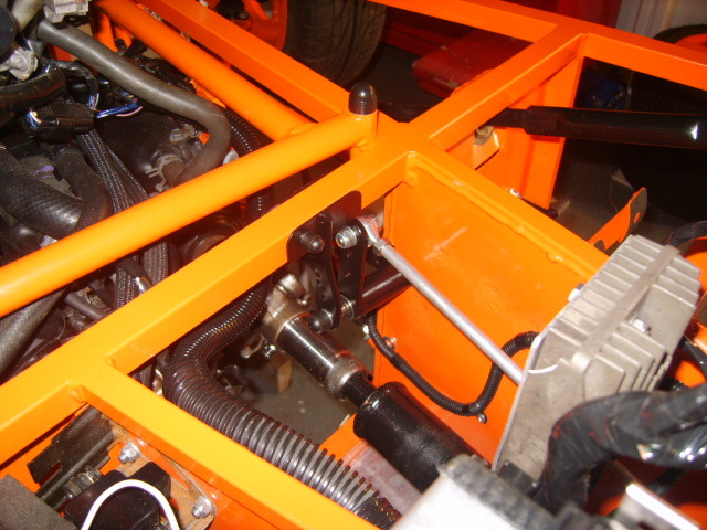

no bearings in mine, I think the trouble with it is the lower pivot might be too close to the pivot point, here's a picture
I have beafed up the rod that connects to the engine
| posted on 26/3/15 at 09:38 PM |
Like what coskev said, the linkage off the bus was Ali bar with 8mm rod ends. Bit overkill but it was free, i would say get some 8mm rod, drill tap
for M6 rod ends.
Ran mine up to the top rail on the chassis and a pivot (a tube with little arms welded on at 90 degrees) and one down to the original bike arm.

not necessarily cheap but our paddle shift
works really well, nice & free (for return to center)
unlike our 1st try with a push pull cable.
good luck
  Paddle linkage 2

Similar to my linkage. This one above means downshifts are on the right hand side rather than the left which I prefer.
My solution (retaining all sierra switchgear) was to mount a pivot hanging underneath the column plastic surrounds using two bearings and a u-bolt (to
clamp around the column). A bar running perpendicular to the column rotates around the pivot. One end of the bar connects to the shift rod which runs
parallel to the column, as per the picture above. The other end of the bar is a handlebar end as the gear lever. It's difficult to describe well
without a photo.
The result is half way between a tunnel mounted lever and a paddle shift. I can keep both hands on the wheel and change gear comfortably. And as a
bonus, I keep all the sierra switchgear!
