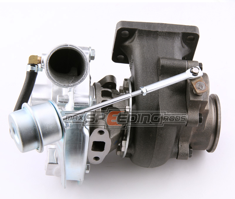

Right.... before I click buy on a pair of these
TD04HL 13T shall I buy them?!

| posted on 19/5/15 at 11:11 PM |
Like this? Looks a bit overkill and the shipping is eye watering!
http://www.ebay.com/itm/CXRacing-GT30-GT3076R-Stage-III-Ball-Bearing-Turbo-Charger-T3-4-Bolt-0-63-AR-/160898933071?hash=item257652e14f&vxp=mtr
| posted on 20/5/15 at 12:34 AM |
Or, is this one better suited?
http://www.ebay.co.uk/itm/221416092250
