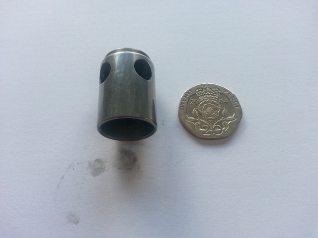

| posted on 24/5/15 at 12:58 PM |
So I'm thinking along the same lines, as the pressure can behave normally for a while, but then rise to +100psi whilst cruising in 5th at about
3k rpm. So I took the valve out again and sanded it with 1200 then 2500 grit.
Before sanding
  oil pressure relief valve pre
After sanding
  oil pressure relief valve post
so now nice and smooth, but still the same thing happens. Could be the channel it runs in is scored and doing the sticking, or something else.
Reluctant to blow £70 on a replacement plastic one, possibly better putting that towards a whole pump?
any thoughts anyone?
laptoprob
| posted on 24/5/15 at 02:10 PM |
Before sanding
After sanding
Ideally you could do with borrowing a good one from someone and swapping to see if anything different occurs. I may have one knocking about at work
that i can send you.
May be worth popping a little cloth up the inside of the valve too just to be sure.
Will let you know on the spare r/v.

Hodor
| posted on 24/5/15 at 02:17 PM |
magic, thanks. Will try with a cloth.
I'm guessing Vauxhall parts dept should be able to get me one too if you have no luck. Not found one on the web except for the SBD plastic one.

Got to be an intermittent sticking valve. Will order to SBD one as I read it was slightly under sized as well, which will help I guess if the bore is
scored.
Thought of sanding the inside of the bore with a bit of wet and dry, but wouldn't want to lose a chunk of it up the spout. But then "who
dares wins Rodney"!

| posted on 30/5/15 at 08:00 PM |
Update on all this...
Bought a replacement valve - didn't fix issue. Checked oil pressure with mechanical gauge and it's spot on. 80psi at 4k revs, just as it
should be.
In the process of all this, found that wire onto the sender was not well attached - re-crimped it on and everything is all good - oil pressure surges
must have been from the poor connection, which explains why on the driveway everything looked good and on driving I was getting wacky readings - must
have been going open circuit and reading high.
