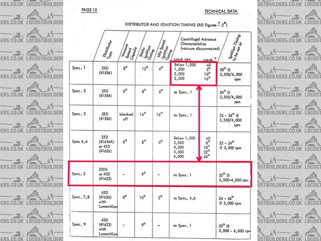

As an aside I have an electronic dizzy fitted with no vac advance and the timing set a degree or two below what's
recommended for the original fuel.
What do we think ?

99 to 100 was 5* so 99 should be fine, you could probably run on 95 without issue, 93 with retarded ignition should be fine
I run valve protector with octain boost and I bottle will do about 20 tankfuls

So, OK to set timing to old 4 star setting if using 99oct ?

| posted on 1/7/15 at 05:55 PM |
If your running a standard engine yes
And also no
Unleaded fuel also contains more ethanol than leaded and the flame front is slower so I would start with where you are and try advancing a couple of
degrees if all runs well with no pinking you can go to the original 4 degrees
That said if you have a manual distributor you will be reducing maximum advance at revs above 3000rpm or so

907
| posted on 2/7/15 at 06:55 AM |
With 98 dB in my left ear and that damn ticking from the SU fuel pump in the other I don't think I'll hear any pinking.
I have a Powerspark non-vac electronic dizzy fitted with timing as, or as near as I can get to, what Lotus recommends. (in red)
  Lotus 907 timing settings
