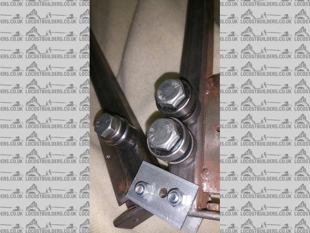

I made up a tool to do this.
  Beading tool
Here is a picture of the tool. Made of some surplus bearings.
This was the result .
  hose_sensor
Gives about a 2mm flare.
