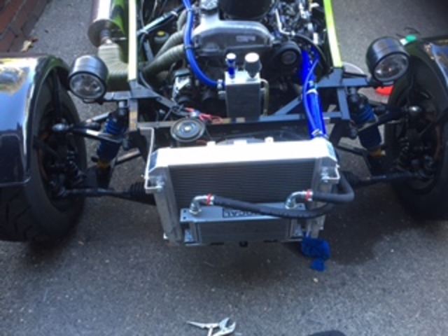

Here's mine

neilp1
| posted on 18/2/16 at 10:34 PM |
I just made 2 Ali brackets and bolt to front of engine front cover
