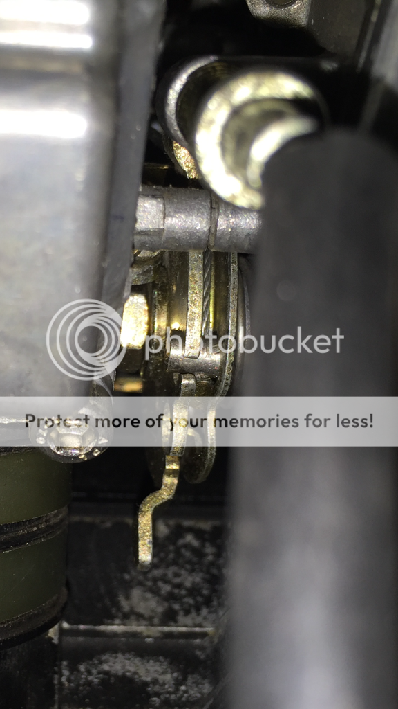

Phil_1471
posted on 9/5/16 at 07:15 PM Reply With Quote
It's pretty difficult to get a decent picture with the air box on sorry. Used same cable as above, but with that brass nipple, no issues yet, done 500ish miles. Initially ran with 1-2mm stretch.

sonic
posted on 9/5/16 at 08:15 PM Reply With Quote
Hi guys
Thank you for your responses and help
James - that's the kit I had and I found it a problem to crimp the nipple on so soldered it, it failed twice. could be my poor soldering though!
Phil - thanks for taking the time to photograph it, I went to a bike shop today and bought a 2m brake cable, the nipple was slightly bigger but managed to file it down so it fits ok. fingers crossed it has cured the problem.
thanks again
