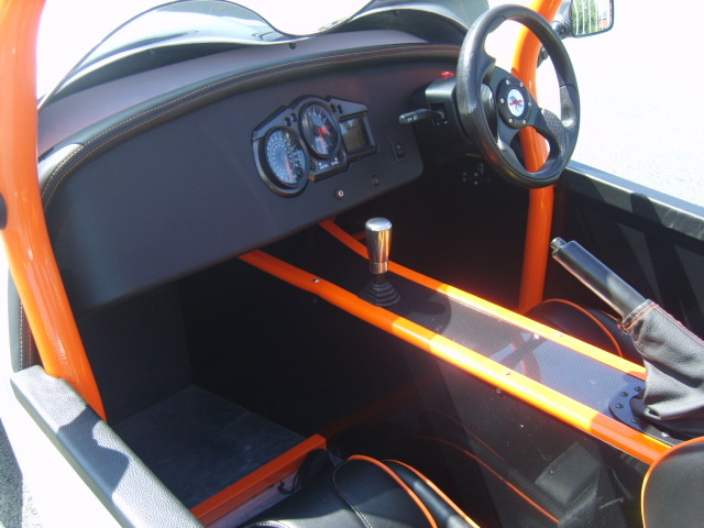

Another vote for the bike clocks, need a Speedo Healer to get the speed reading correctly, I always mount them so they can be seen thro the top of the
steering wheel - can never understand having them in the middle of the car !
zx12r dug
| posted on 2/9/16 at 12:35 PM |
Like to see a pic of them mounted behind the steering wheel neatly as there big clocks

I'm interested to find out what info the zx12 clocks show? Oil temp and pressure? Water temp etc.
Can the bike fuel pump and sender be used in the car tank?
Also are there readily available wiring diagrams? I read that Haynes never did a manual for this bike

I used the sender but had to shorten the arm shows correct when low but shows full for a while as the tank is taller than the arm.clocks show water
temp and oil light.Always worth adding a volt gauge only a few quid
