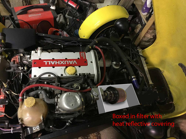

My F27 (running a red top) was on the rolling road last year and the chap noted that the filter and pipe was the cause of quite a drop in BHP. I would
like to improve this, so was planning on firstly buying a decent filter, and then secondly moving it inboard, so there are no awkward pipe bends, and
a quicker route for the air inside.
So question number 1, is can anyone recommend a good filter. My ignorance has me planning on getting a K&N one like the one linked below, but
please advise if there are better routes to go:
http://www.demon-tweeks.co.uk/performance/universal-air-filters/kn-filters-universal-round-tapered-air-filter
Secondly my plan as shown below is to box in the filter, and the cover the box with heat resistant material.

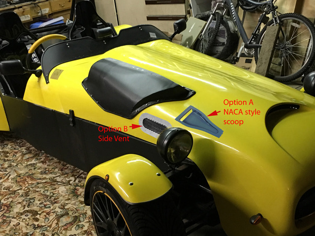

Then it is a question of how to service the filter with air. I am thinking bonnet scoop (NACA style), or side vent. (see below)
[img]
  Air FIlter Air flow 1
[/img]
Could anyone suggest what will be better?

Could you not extend the pipe all of the way forward so that the filter is infront of the rad?

With your current setup of the std inlet manifold and throttle body the gains or losses will be equally minimal to be honest. I used to run the XE in
my Astra when i was in my early 20's and experimented with loads of options. The K+N type filter you have on all ready is fine for your setup
but at Bizzle said i would extend it downwards to make full use of any cold air coming from the front of the car.
Ideally i would ditch the lot and put on bike carbs or better still throttle bodies then you'll free up approx 25-30hp from the current
setup.

To be fair as Laptoprob says above with the standard set-up its always going to be a compromise
You need the filter to be located in as Cold an airflow as possible, So your going out of the bonnet or as said in front of the rad
Budget dependent but TB's would make a big difference or bike carbs as a cheaper alternative
