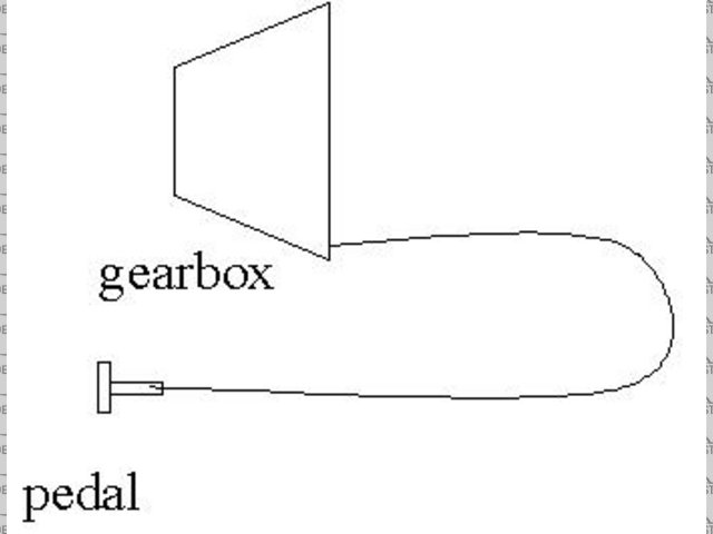

My clutch feels very stiff to operate. I can only put it down to the acute loop the cable takes from the floor mounted pedal to the type nine box. The
cable is of the type with an eyelet on one end (pedal) and "ferule" (normal type nine end) on the other. I think forcing some grease down
the cable would help matters. I think I could do this by connecting a tube (caulking gun type) of grease to the cable end with some hose and hose
clips.
Question is what type of grease to use , or is this a bad idea ?

Question is did you replace the clutch, if not then it is likely to be the clutch cover gone stiff. If you replaced was it a new item or
reconditioned. If reconditioned the it is likely to be faulty. If none of the above then I suggest as a first move that you find a less torturous
route for your cable. The last thing that you want to be putting down a new cable is grease or lubricant.

givemethebighammer
| posted on 8/1/05 at 02:48 PM |
the clutch, cover and release bearing were all new. It will almost certainly be the loop in the cable causing the stiffness. problem is I have no
other way of routing it. I'll take another look later.

| posted on 8/1/05 at 03:15 PM |
There is a longer cable you can use which should make a larger arc,i think it is cortina P100 or early sierra P100 pickup the ones without the
automatic adjuster on the pedal.
I also have a cable from an 85 transit i may try as that is a touch longer in overall length too.
