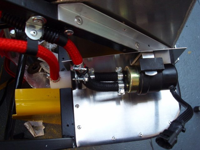

  Fuel pump mounting, close up

40inches
| posted on 8/2/18 at 04:41 PM |
quote: Originally posted by mcerd1
quote: Originally posted by 40inches
I ran a plastic/paper filter, about £5, pre carbs with a standard bike filter pre pump.
Yeah, I've been looking for ones like that but can't find any with more than an 8mm tail
I've tried using 8mm hose on the pump and carb tails but its just not a good fit with the hose I can get hold of and is likely to just damage
the hoes (the OE bike hose is a lot thinner and seems to have been stretched over the bigger tails)
if anything I know the 50 micron glass one before the pump is overkill, but thats the easy & cheap bit to sort out....
[Edited on 8/2/2018 by mcerd1]
The black to red connector is a 10mm to 8mm reducer
