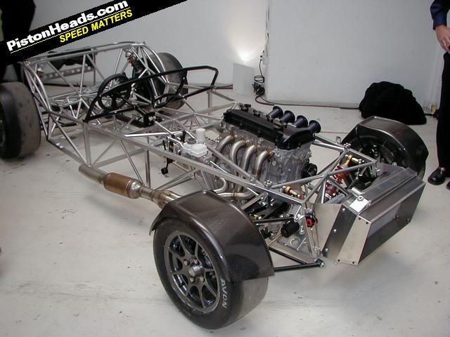

I'm using a pretty tiny rad but this allows me to fit it slanting out slightly at the top (opposite to most rads in 7s). This in turn will allow
me to duct the air from the back of the rad out through the top of the nosecone/bonnet. I can't see much point ducting air into the rad if it
then has nowhere to go afterwards. This will create higher pressure after the rad (not conducive to getting air through it) as well as drag on the
vehicle.
Despite the relatively small area, my rad is about 2" thick and twin core, so probably has more water pipe and fin area than a micra rad or
whatever. Oh and it's black which might help a bit.
The only source of concern is that it's from a tiny engined fiat 126 and i want it to cool a large V6 (eventually turbocharged). Hopefully
it'll be OK. Production cars tend to have massive radiators even for small engines probably because they must get awful airflow through them -
through a small restrictive opening then straight into an engine. I guess the plus side to the large-rad-crap-airflow approach is that it is
presumably less sensitive to speed than a small rad with good airflow. I might need a bitchin fan to keep me cool if i'm ever stuck in
traffic.
F1 cars also have tiny rads (there's one on ebay) and Caterham are doing the same as me on their new CSR, which is reassuring.
