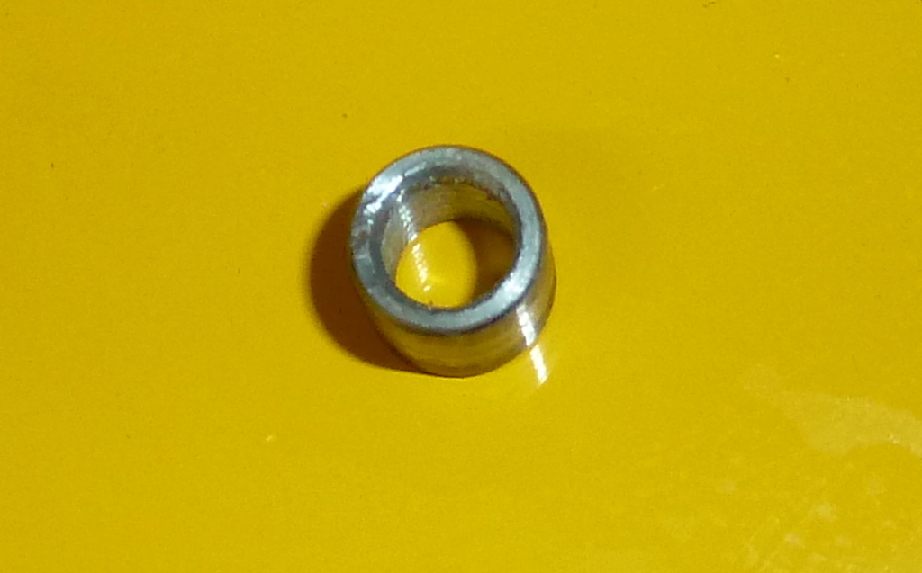

Over the weekend I tried it out - spent 10 minutes turning a small sleeve on my lathe, fitted it, and now I have fast idle on cold start!

Now, a question: can anyone suggest an adhesive I could use to fix this sleeve in place on the pin? It's a stainless steel sleeve on a steel
pin. I have some Loctite 601 that I could use, but I'd never be able to get the sleeve off again if I wanted to make some adjustments.
I'd like something that would keep the sleeve in place, but would allow it to be pulled off if necessary. It would have to be resistant to
petrol fumes and heat, so Bostik might be pushing my luck!

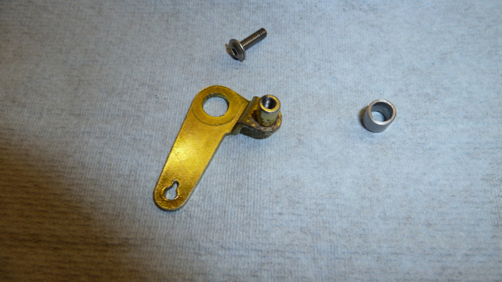

A few pictures (pin highlighted) - the chunky wire on the left of the pin is the one that's meant to be bent.

It is an option, but the wall of the sleeve is very thin. I'm not sure how many threads I could get in the thickness.
I'd rather not modify the linkage itself, but I do see what you're suggesting... my worry is that there's a fair chance of making an
expensive mistake! Also a bit fiddly to do it in situ, and I don't want to take the carb off again if I can avoid it.

Done!
The peg now has an M3 threaded hole in it...
Usual thanks to everyone who contributed - your comments did make me think about the problem, even though I only followed one suggestion...
