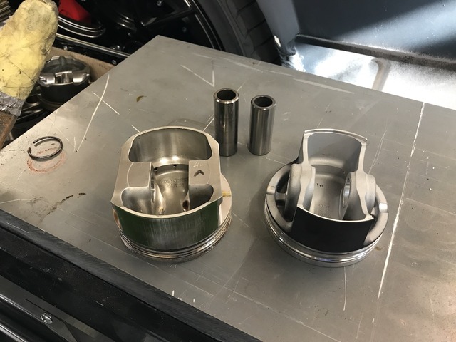

Below is a picture of the forged pistons for the engine, his (and my new ones) are similar to the ones on the left which are the cosworth ones that came out my old engine..... his squirters will be spraying the centre of the flat underside section of the piston, and at BDC it will be a few mm clearance max.
Also IMO the insert is best to screwed into the bearing side not the piston side and be at an angle to actually spray the crown.. gives more clearance to the piston and means it can't come out within the bore... I used a non return insert that only sprays above 30psi, the stock noble ones are just a small hole (around 0.6mm I think) so spray all the time.
The solution is simply to drill them at an angle so they point at the crown which is what all squirters i have seen do, I used a scrap block and drilled each one differently and then selected the version that worked best.
