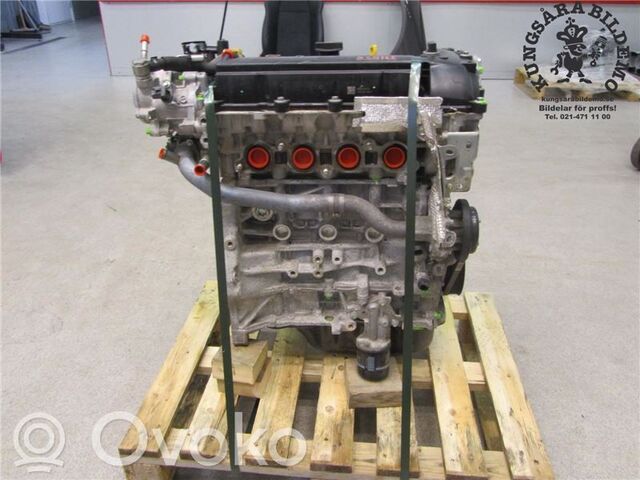

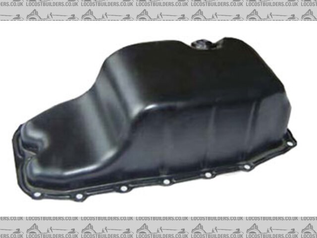

monsterer
posted on 24/10/25 at 08:13 AM Reply With Quote
Just keeping this updated. I think I've found one - the Mazda 3 MPS engine is the same family as the duratec and it has a semi-front sump by design.
disi engine
disi engine
disi sump
disi sump
