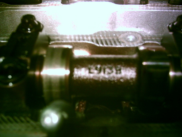

Cam Picture attached
Could not get a good picture but here you go.the cam has got L9138 stamped into it and the housing thingy HB, does this help

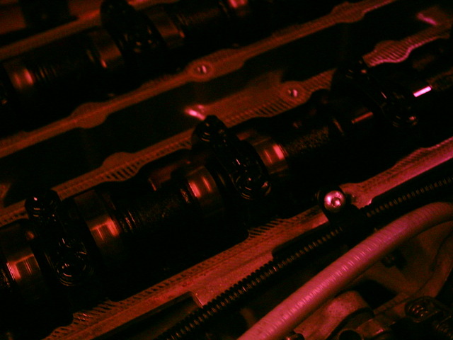

Camshaft Picture
Better picture i hope

unfortunately, the pics don't give the detail i would need.
The identification comes about from a 5 character code, taken from the front of the camshaft.

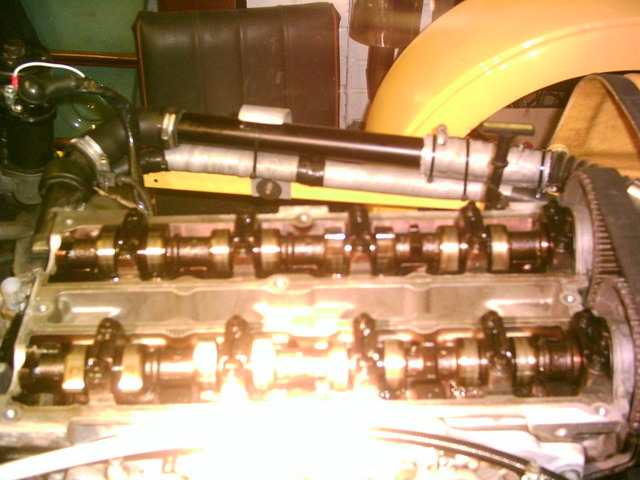

Think I got it
Passenger cam: 0,0,1,1,
Driver: 1,0,0,1,
CliveM
posted on 18/3/05 at 08:16 AM |
got enough info now to identify your cams as 105PS.
Passenger = Exhaust = 928M-6A269-GA
Driver = Inlet = 928M-6A266-GG
Service engine part number 928M-6006-KA
