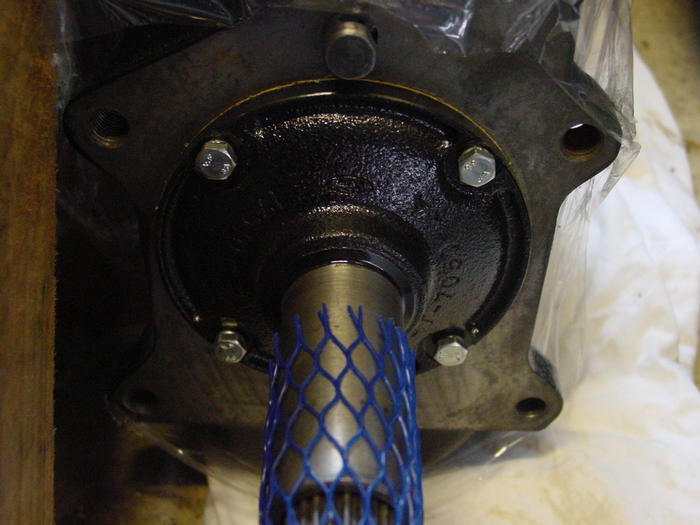

Thanks! If I post a picture later today can you give me your opinion?

Picture of front of gearbox!

Not quite I'm afraid! Can you takle the pic at a bit of an angle to one side of the front of the 'box? The boss I am on about is under the input shaft on your pic!
If there is a boss there, it's heavy duty. If there is just a 3/4" shaft flush with the end of the casing, it's not.

I'll have another go tonight but I don't think there is a boss there from memory.

Looks like a visit to BGH for me then! There is no protruding boss under the input shaft.
