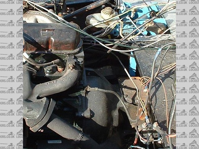

Heres a pic of the engine location (I know its a bit of a mess):
  Engine Location Close Up
The bell housing is a country mile away from the bulkhead!
I will have a go at a z style stick extension otherwise i'll have a crack at the linkage setup.

As a rough guide with a 4 speed & xflow the top of the gearbox cover should only be slightly protruding from beneath thebulkhead top panel iirc.

Looks like the engine could move back a fair bit.
