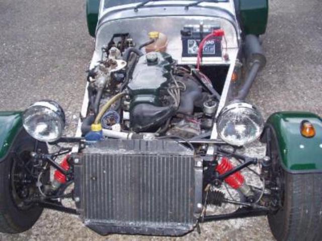

Surrey Dave
| posted on 17/5/05 at 09:30 PM |
Like This.............
Surrey Dave
| posted on 17/5/05 at 09:31 PM |
And This..........

Surrey Dave
| posted on 18/5/05 at 12:00 PM |
505mm wide to the edge of the mountings, 370mm high not including filler neck....
