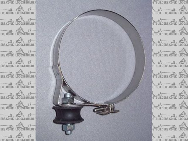

Your "P" design is a bit flexible at the point where the straight meets the circle.
I use an "L" shaped bobbin mount.
See pic of mine below.
I hope this is of some help.
U2U me if you need further advise.
ATB Paul G

Thanks for the advice. I have adapted my "P" clip to be more like your "L" version and I will look for a chunky rubber
mount.

... and here is the finished item!
  Rescued attachment 2005-06-11 4 Locost silencer strap on mount and support 2.jpg
907
| posted on 13/6/05 at 10:07 PM |
Excellent
Top job mate. 10/10
I bet you got a lot of satisfaction out of making that.
A true Locoster
