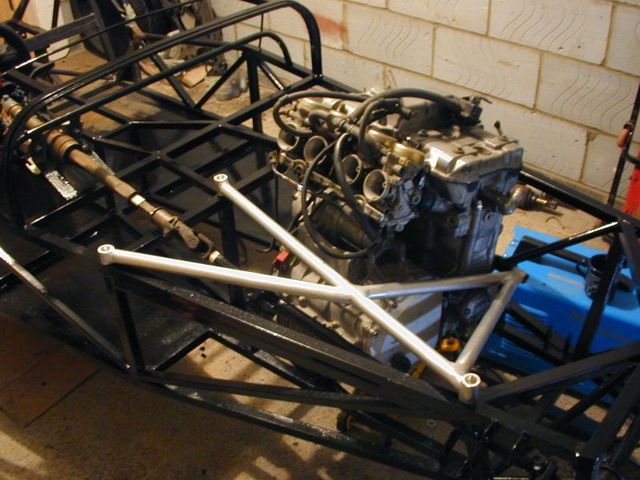

Try your MIG on Ally!
I did for my engine brace and it seems to hold together under no load at all so maybe your inlet manifold will too!
Its something to try anyway. QUite satisfying when you crack it (welding ally not the... tube / swaneck / etc etc)
