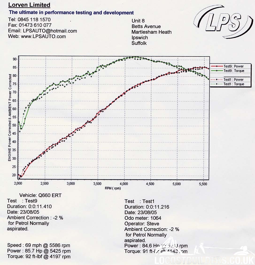

I took my car to a rolling road yesterday - and found that I had the jets pretty much right, and that the engine's only producing about 85 HP.
engine = 1660cc X-flow, GT head.
carb = Weber 32/36 DGV
cam = Kent BCF2
electronic ignition dizzy
free-flow exhaust
With this setup I had expected a bit more (or am I over-optimistic?)
After fiddling around with the carb the tuner decided that the primary choke was rich, while the second was correct. If he adjusted the mixture on the primary the mixture went lean when the secondary opened, so I lost power. The only gain to be made was to advance the ignition a bit - which gave me an extra 1 HP!
He was wondering if the cam was a bit too hot for an engine that's barely modified - but I had been assured by the Kent techie that it would work OK on my setup (but he would say that, wouldn't he!).
The only thing that was obviously limiting my power was the fact that I'd set my rev limiter to 6000 rpm, when the cam is rated from 2000 - 6500rpm. the soft cut-out was also coming in at 5800 - 5900, which spoilt the top end power. I wasn't sure what the max revs is for a standard-ish x-flow - can anyone tell me? The tuner suggested a hard cut-off at 6200rpm would give a noticeable bit of extra power.
Finally, can anyone suggest a not-too-expensive way of actually using the cam's power range? I don't really want to change the cam as that's a total PITA on a x-flow, and I don't want to go to the expense of a pair of DCOEs just at the moment.
All suggestions gratefully received!
rgds,
P.S. The car still feels good and fast on the road, though!

posted on 24/8/05 at 06:14 PM Reply With Quote
Replying in no particular order...
I used the standard cam peg to locate the chainwheel - but when I checked afterwards it was very close to ideal.
I would have been happy if it was BHP at the wheels - but the man told me it was the calculated flywheel figure. It doesn't say so on the print-out though.
Everything in the carb is set correctly - float, etc.
If I was confident about max revs with a x-flow I'd take it a bit higher - but I can't get any authoritive statement on what max revs are safe with a standard x-flow. I don't mind if it rattles the valve springs more than it should - just that I don't want to break anything!
It's not encouraging to compare my car with a Locost racer - I've got 360cc's more capacity, and a bigger carb!
The general comment that "if you're happy with the way it goes, why worry" is fair, though. It does go like stink, with a nice health 'rasp' at full throttle!
Here's the Rolling Road Chart - it's a bit large for here!

scoobyis2cool
posted on 24/8/05 at 06:36 PM Reply With Quote
Looks like you've got a healthy spread of torque, so I shouldn't worry too much about the peak power. And as has been said, if it goes like stink don't worry about it too much!

posted on 25/8/05 at 08:26 PM Reply With Quote
David,
That torque curve looks very similar to mine (piper 270 cam). This doesn't give much increase in power but a lovely torque spread.
I am a little surprised at the power figure considering a standard GT/Ghia crossflow gives 86bhp. I would expect in the region of 100.
