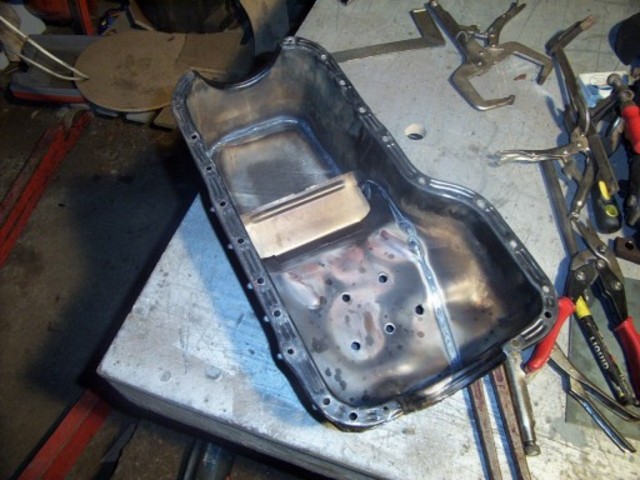

Mark Allanson
| posted on 8/2/03 at 07:18 PM |
There, I did it!
Mark Allanson
| posted on 8/2/03 at 07:24 PM |
I have left the lower part of the sump intact (with a few holes to aid oil recirculation), the oil capacity is now probably about 15 pints, but this
should aid cooling.
I havent put a baffle in yet, will I need one with this set up?
