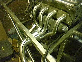

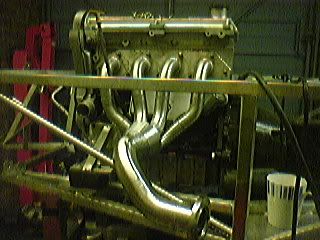

zetec exhaust manifold
what do you think of this for a manifold ?.
[Edited on 4/11/05 by kevin booth]
Surrey Dave
posted on 4/11/05 at 10:40 PM Reply With Quote
Did you make it?
I was thinking of making something similar ,so I could exit through my existing hole in the side panel.
The primaries are possibly a little short but it would work.
kevin booth
posted on 4/11/05 at 10:49 PM Reply With Quote
Originally posted by Surrey Dave
Did you make it?
yes, out of 8 1,1/2" bends, 4"x2" reducer and 2" exhaust pipe in stainless steal.
Big Stu
posted on 5/11/05 at 02:37 AM Reply With Quote
Looks good but if you can, you might be better with longer primarys, and try and keep them all the same length
