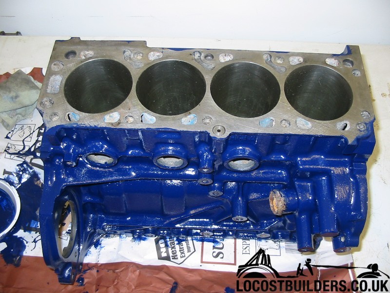

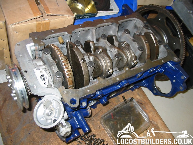

http://www.locostbuilders.co.uk/upload/IMG_1503a.jpg
before:
http://www.locostbuilders.co.uk/upload/IMG_1443.jpg
and this weekends progress:
http://www.locostbuilders.co.uk/upload/IMG_1511a.jpg
http://www.locostbuilders.co.uk/upload/IMG_1514a.jpg
http://www.locostbuilders.co.uk/upload/IMG_1515a.jpg
