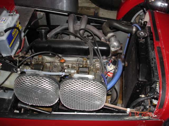

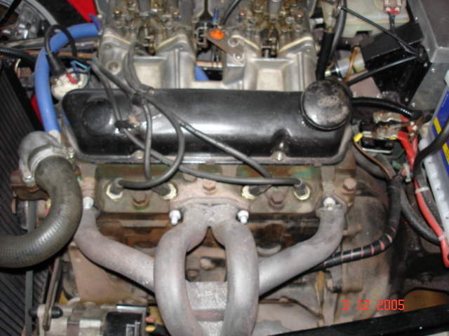

2. The engine does not match any of those in the Haynes Capri manual and does not match that on the V5. Does anyone recognise it from the photos?
Engine number is: 711M 6015 AA - does that identify it and which car it came out of? Any info. lie cc and CR would be useful.

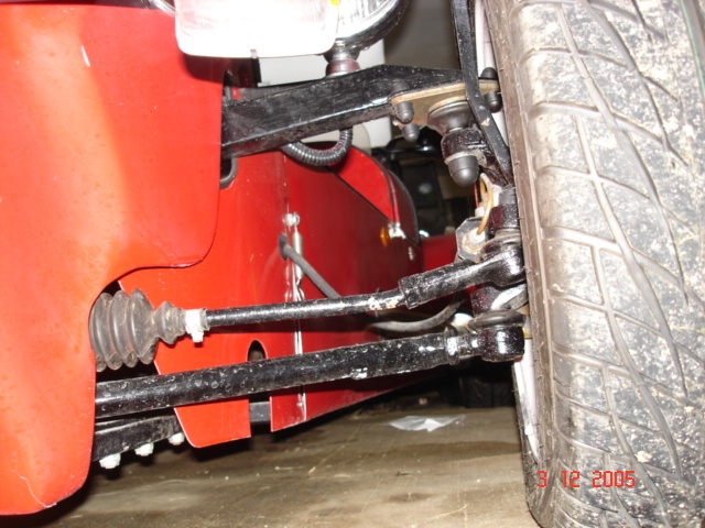

3. The steering rack arm is bent - is it safe to straighten it by bending it in a vice?
  bent steering arm

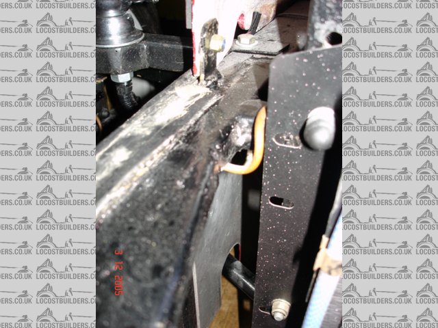

5. The brake pipe is bent in a tight bend over the frame - stupid really since there is no reason why the hole for the brake hose could not have been
put in front of the frame upright instead of behind - is that safe?

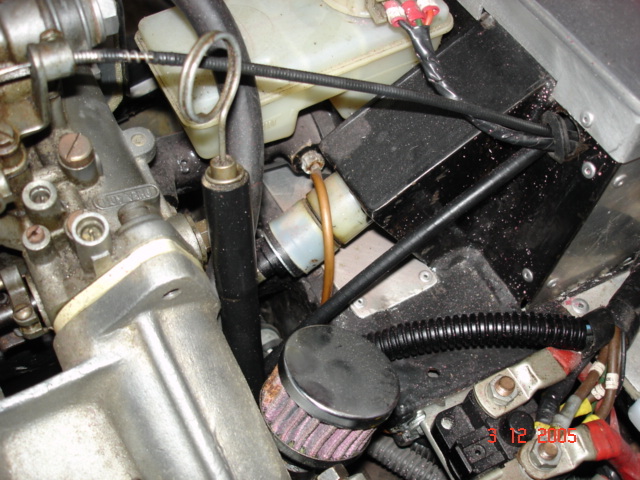

6. Similarly a tight bend from the brake master cylinder - is that ok?
  tight m/cylinder brake pipe

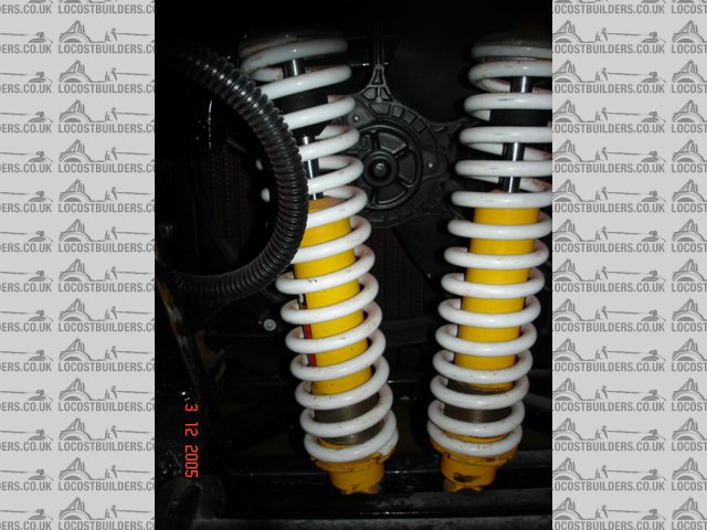

7. As someone pointed out, the wishbones should be parallel to the ground; if they were the nose would be a bit higher up.
Looking at the shocks they don't seem to have been wound. Would winding them up i.e. compressing the spring lift the nose up or have the wrong
length shocks been fitted? (Not easy for me to try since I don't have the C spanner and need to remove nose cone).

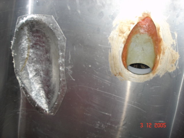

9. There is a scoop fitted to the bonnet too - not sure of the purpose, maybe to let in cold air to cool the exhaust. Filler seems to have been
used to smooth down the dges and it has cracked - no surprise. What would be a better medium to use? Ideally I would like to MIG weld an ali scoop
or if that fails using rivets. I know there is some rule about sharp edges here, can someone remind me what that is. Or maybe fit a
louvered panel. I would like to use all ail parts as I don't want to paint the bonnet. Fishing for ideas here.....

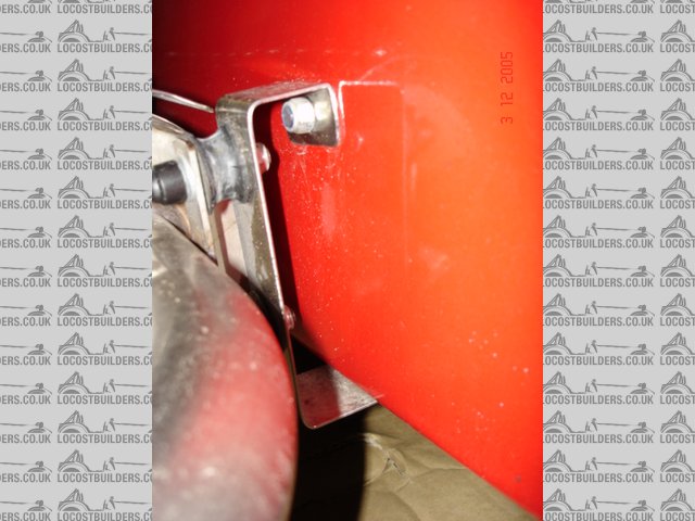

10. The rear exhasut support seems to shake a lot and I would imagine over time the ali side panel will tear. I plan to fit, probably by welding, an
L shaped bracket to the bottom frame rail, drill through the vertical side so that there is more support - good idea? What have other folks done?

1. Not sure.
2. Its a cross flow engine most definately. Cant remember how to identify them though!
3 i. Probably Capri, but could equally be escort or cortina.
3 ii. Not you cant bend the track rod back. I had the same problem on the rack I got and was advised to get a new one... which is indeed the correct
advice!

5 and 6. As long as the pipe isnt kinked it will be fine
7. Compressing the springs will raise the nose

2 crossflow - if no one else pops up, remind me and i'll check the bible (Wallage) and see if you can get capacity it from some of the engine
numbers.
3 if its already bent its been weakend. you could bend it, just like you could (insert seemingly good idea but actually not here). get a new one -
costs about 30 quid. 80 quid from rally design gets you a quick rack

5 & 6 agree
7 agree, c spanners can be had for less than 10 pounds. The shocks look like spax which aren't well regarded by the westfield lot - but if they
work, they work! depends what you want the car for.

remembered, the 1600 engine is 1" taller in the block than the 1300 engine. Of course i haven't a clue how tall the block is - boy am i
helpful this morning
deep down inside I knew replacing is the only option - last thing anyone needs is for the arm to let go at speed
So I need to identify the rack - anyone? Plus can I just buy the arm or the whole rack?

rack - most likely a mk2 escort .......

2. The engine number quoted is the block casting number, not engine number, 6015AA is 1300cc . BA is 1600cc.
There is about 20mm of cylinder block casting above the water pump on a 1600 block , a 1300 is nearly flush with top of pump casting.
The actual engine number is stamped on a flat cast onto the top right hand side of the block looking from in front just behind the thermostat housing
Paul.

omega 24 v6
| posted on 3/12/05 at 03:32 PM |
According to this link http://lotus-cortina.com/library/block/blocks.htm the 711m6015 block is a 1600 block although this contradicts an earlier post.
I don't know what the AA stands for though so hopefully someone else will have the full Kent engine code decoder

Just checked in the Burton power catalog and it quotes " Look at the casting marks 1.3 is 711m 6015 AA 1.6 is 711m 6015 BA."
I think in the link posted they were talking of 711 M 1500 and 1600 blocks in general and didnt mention the smaller 1300 AA blocks.
The definite check is the distance from the top of the water pump to head gasket joint.
Paul.
