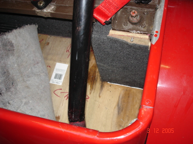

11. Boot is lined with marine plywood, looks nasty. I plan to redo it in aluminium - what would be a suitable thickness? Also I would fit ali
angle
underneath running from side to side to strengthen it - any other ideas welcome.

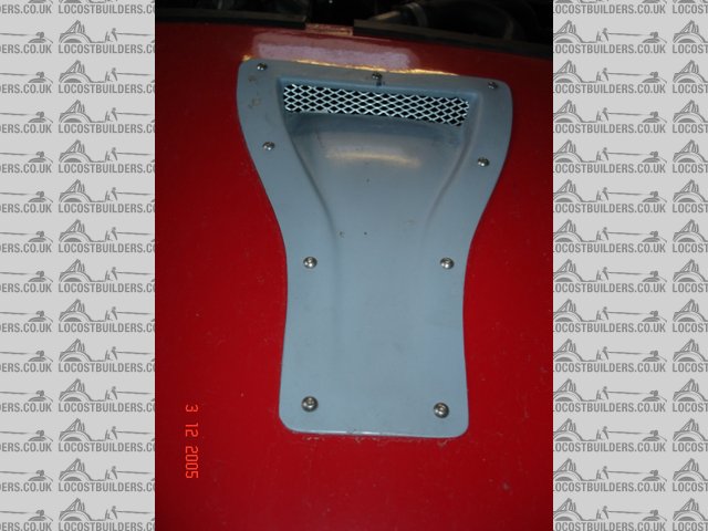

14. The nose cone scoop doesn't look like the best fitted job and is not very big. Here I may try to lower it a bit so the top surface is
smooth or fit a larger ali scoop. Again fishing for ideas.

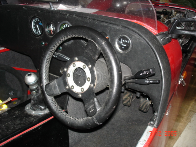

15. Has anyone tried to shorten the steering column stalks?
  steering wheel stalks

15 - leave it a while ........ probably possible but you've got other things to do that stop SVA.
