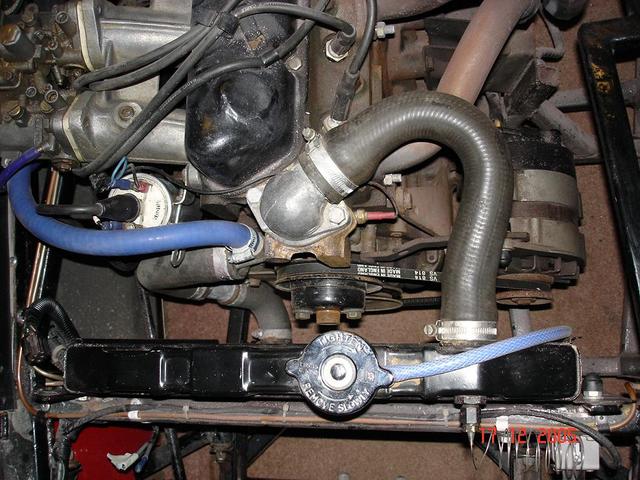

purpose of small pipe in thermostat housing?
I have a spare thremostat housing that looks like it will fit xflow engine:
  thermostat housing
What is the purpose of the small pipe? My current set up does not have this so I plan to cut it flush and plug it..... unless it is used for the
heater? (or for a remote tank?)
the attraction is that the hose from the thermostat to radiator will not have to curve backards plus I have the possiblility to fill up via the hole
for the switch should it tun out the radiator cap sits below the thermostat housing.
  thermostat to radiator hose

ditchlewis
| posted on 19/12/05 at 11:28 AM |
Is it for bleeding the cooling system?
ditch
| posted on 19/12/05 at 12:04 PM |
It's the bleed pipe goes that leads to a pressurised header tank. Something worth considering, as you have the part already available.
I have the original-style non-pressurised overflow/recovery tank that works OK, but this system can be a total PITA to bleed out all the air.
With a pressurised system that's set up properly, the air just goes out to the top of the header tank, without fuss.
rgds,
| posted on 19/12/05 at 12:05 PM |
i bleed mine by taking out the thermostat. Could be used to bleed it or it could go to a header tank.
froggy
| posted on 19/12/05 at 12:06 PM |
that will be a stat housing from a mk1 xr2 and the little pipe is indeed a bleed to the header tank
02GF74
| posted on 19/12/05 at 01:39 PM |
so is there an equivalent without the bleed pipe with the main outlet pointing in the same direction?
sounds like the small pipe may be useful so I guess what people do is fit a small pipe and block it using a bolt?
froggy
| posted on 19/12/05 at 03:04 PM |
id keep it and put a small header tank on the scuttle which will free up your choice of rad and give you a thermo switch at the hottest part of the
coolant system
