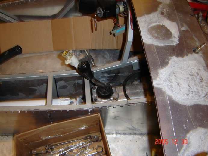

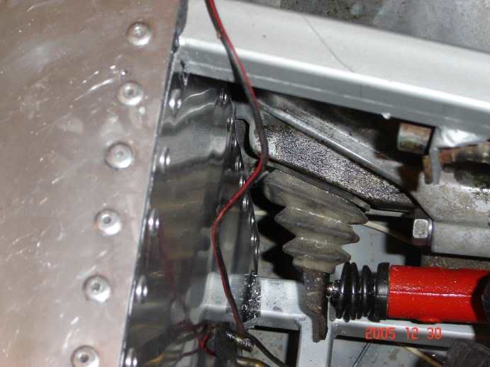

My "book" chassis has been shortened almost 3" in the cockpit. I did not have to alter H nor did I have to build a remote shifter. I did bend the hell out of the (shortened) shifter.
Don't mind the corrosion on the aluminum - bought from a scrap yard and will be wet sanded eventually.
Some other pictures here:
http://www.geocities.com/g_wellwood/automotive/locost.html
Another local guy built a book frame with a 4AGE and had to fabricate a remote shifter. The result was sloppy, but do-able.
