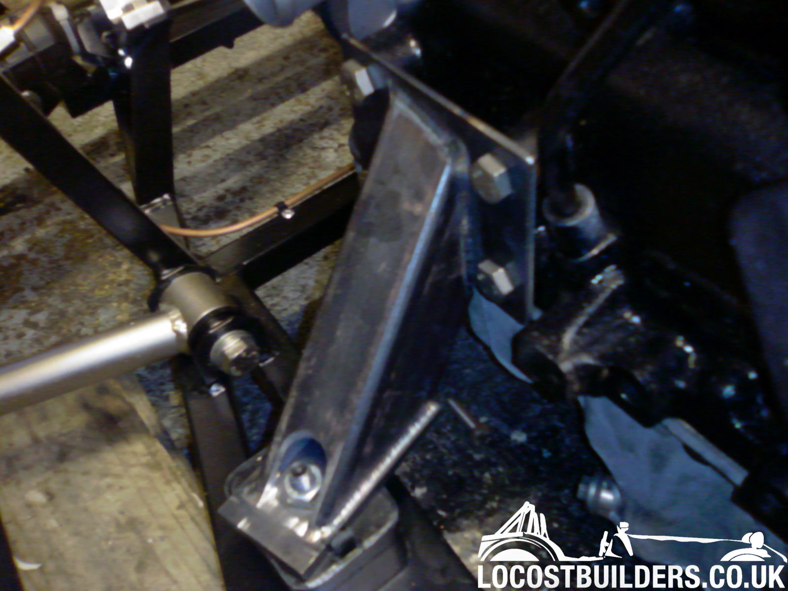

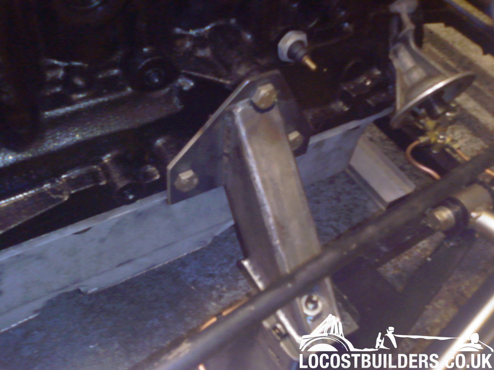

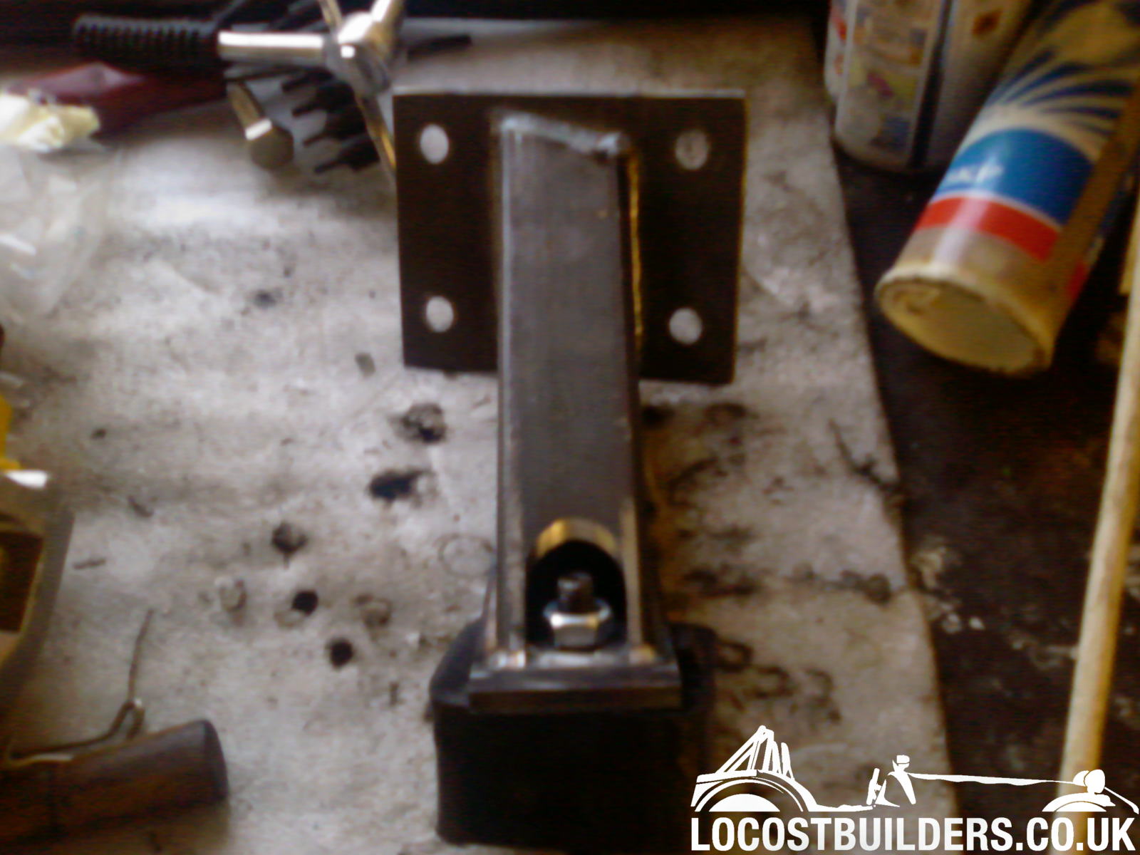

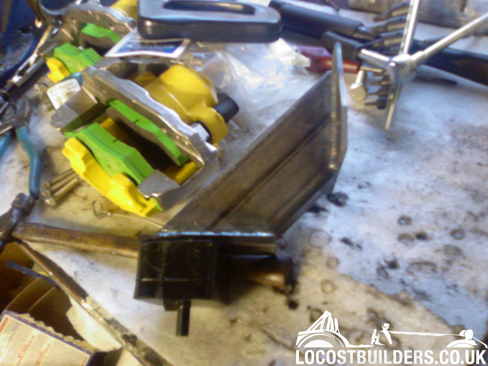

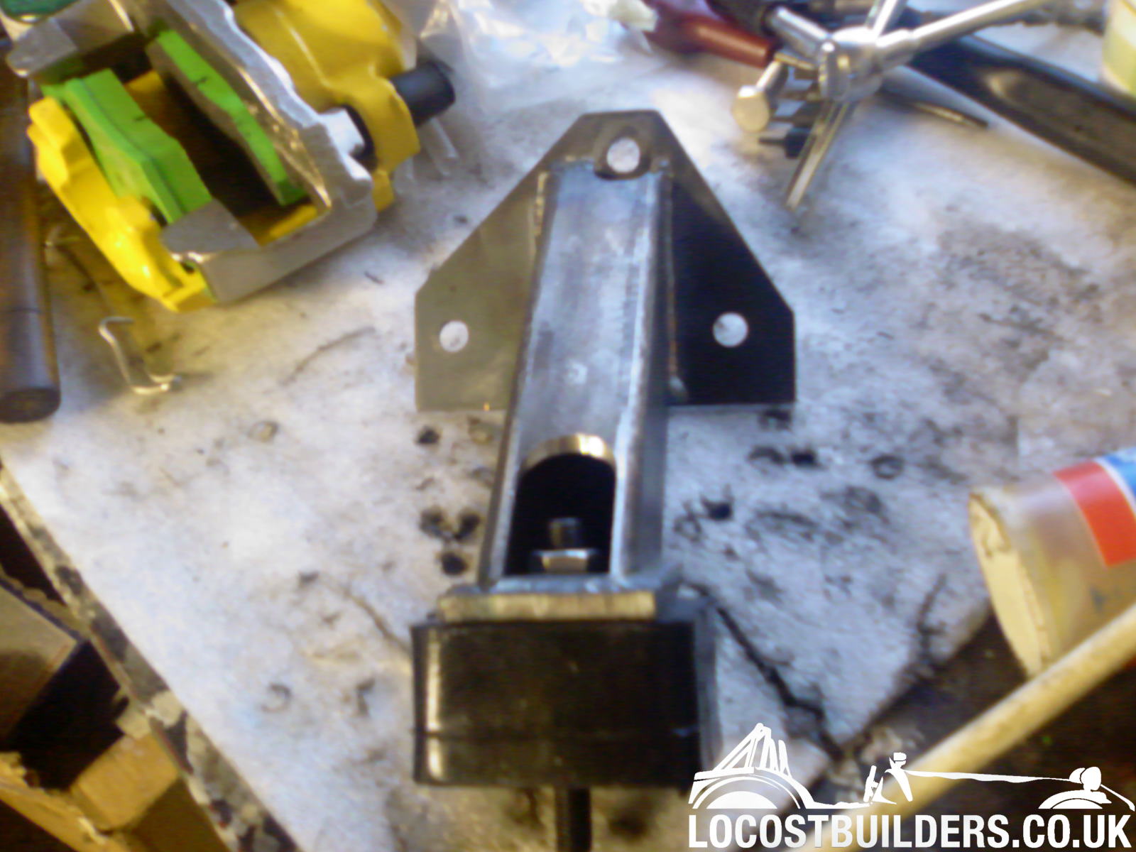

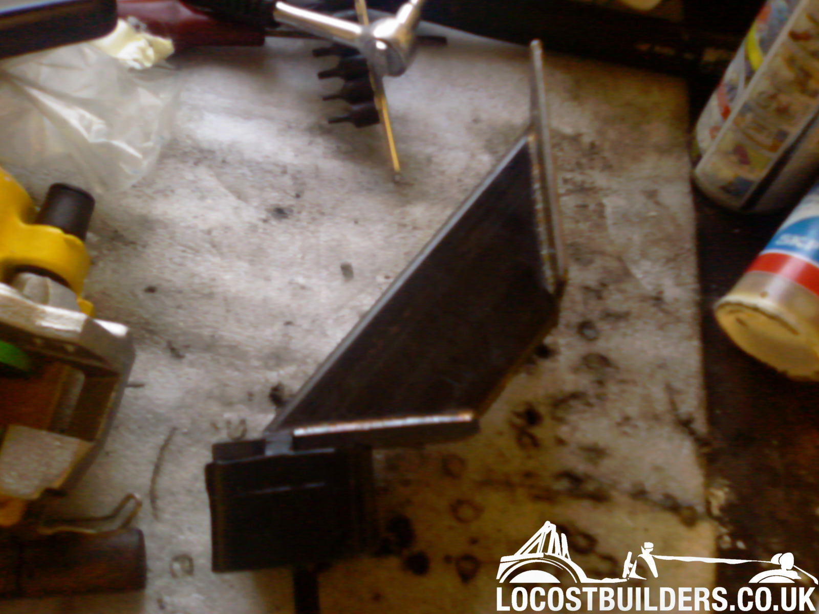

Hi guys,
Just finished doing the engine mounts for my Luego.
I looked around and nothing seemed to deliver quite what I wanted - so I used some MK3 Fiesta Gearbox Mountings and got my Dad and his mates to
fabricate some engine mounts. Massive respect to them - they look ace.
There's no play whatsoever in the engine - I'm delighted.
Next step is to get them nickle plated :-)

donut
| posted on 25/1/06 at 03:29 PM |
yep, they look the nuts! Look good and strong. Wanna make some for me?

givemethebighammer
| posted on 25/1/06 at 10:22 PM |
They look good, pretty much the same the ones I made for my zetec. Better than some of the commercial offerings I have seen (no manufacturers
mentioned)
