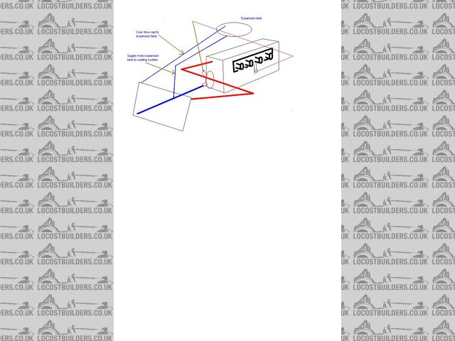

ditchlewis
| posted on 6/2/06 at 11:48 AM |
Here is how i plumber mine in, hope it is of some help.
ditch

Personally I havent fitted an expansion tank and have plumbed mine as follows
Top of rad connected to top of block (exactly as in your first pic)
Bottom of rad connects to bottom of block. Discharge from this goes under the exhaust headers over bell housing and forwards to carb connection. Job
done.
Ive seen the expansion vessel connected in to this line as well using a t piece, with the top hose connector on the ex ves blanked off.

I have the same components and have it set-up thus
Top hose as per your pic 1.
Expansion tank (D) to Water Pump (B) with a "T" in the middle of the hose to the inlet manifold (E)
Expansion Tank (C) to small thermostat outlet (un-labeled)
Bottom hose between water pump and bottom of rad.
Seems to work OK and holds good temp when idling for long periods.
The Astra expansion tank does seem to hiss a lot, but then it may do in an Astra and you just don't notice it.
How long til' your on the road then Andy?
Nick

| posted on 6/2/06 at 12:08 PM |
Mine's an Escort rad.
I ran the air bleed one on the thermostat housing, just above the B in your picture, to the equivalent of the C on your header tank, then B to the E
on the manifold with a 'T' made from plumbing fittings to the D bottom of the header. A is the bottom hose. The Polo rad doesn't
have an overflow does it?

| posted on 6/2/06 at 12:26 PM |
Jos,
I've since added the pipe in red, which returns from the water pump to the expansion tank.
When cold, the water flows back into the tank through this pipe, but once the thermostat opens, the flow stops.
Nick
PS - I am no expert and have followed the advice of others on here with similar set-ups Image deleted by owner

| posted on 6/2/06 at 12:31 PM |
There seems to be an infinite variety of ways to do this!
Mine's got an Astra tank but is different too!
Also a 32/36 carb.
Pump to bottom of rad.
Thermostat to top of rad.
Blank off thermostat small connector.
Manifold (water out!) up to choke.
Choke to top of Astra tank
Bottom of Astra tank to pump small inlet.
Hope that helps!
James
- Muhammad Ali

Andy,
It's easiest if mentally you split it into two systems: 1) the main ins/outs to the radiator ie. everything outside the thermostat. 2) The
engine associated parts ie. the stuff inside the 'stat.
