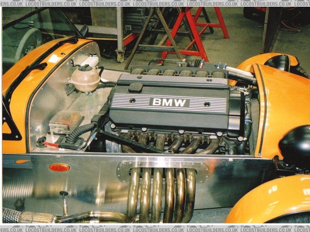

I still hold out hope that one day I'll see the pictures of the BMW viento that you said you had...

Paul (Notts)
posted on 24/2/06 at 11:41 AM Reply With Quote
Paul (Notts)
posted on 24/2/06 at 11:42 AM Reply With Quote

graememk
posted on 24/2/06 at 11:51 AM Reply With Quote
now i'm liking that

Thanks a lot paul - much appreciated!
Ground clearance eh? What made you think of that?! Mine was about 120mm when I had a pinto in it, and I'm not planning on having that change.
