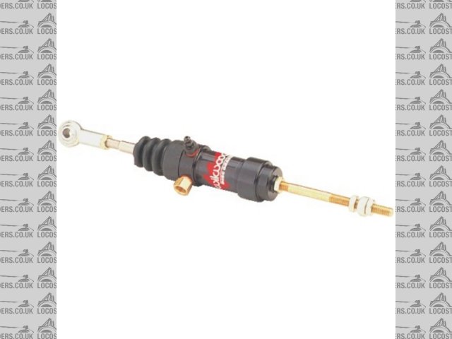

| posted on 27/2/06 at 10:41 AM |
What slave cylinder should I (see pic's)

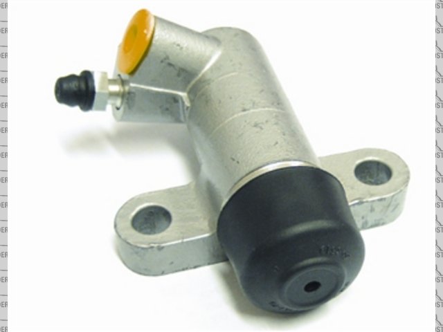

phaeton
or this one
phaeton
| posted on 27/2/06 at 10:43 AM |
Has anyone experience with them, and how do they fit on a type 9 box?

phaeton
| posted on 27/2/06 at 11:45 AM |
I'm really looking for a external bolt-on type of device (i don't want to get the gearbox out).
Has anyone experience with girling or wilwood ones (see pic's prev page)?
And which one is the easiest to mount/ best choice?
omega 24 v6
| posted on 27/2/06 at 12:44 PM |
The BIL uses a wilwwod one on the hotrod with an XE engine and Type 9. It seems to work just fine but is vulnerable (position) to grit and salt etc.
