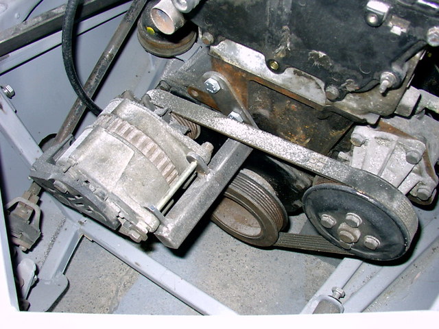

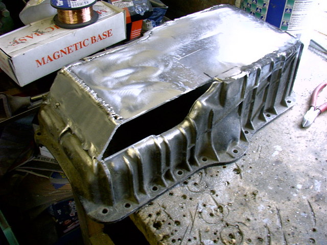

Thank you all for replying to my questions so quickly. It is reassuring to see that the ford 2.0 DOHC/mt75 gearbox is being used in the locost. I have
some question may be paulBuz could help me? How much did you have to cut off the bottom of your sump and was it difficult? How did you get around the
clearance for you alternator? And did you have to move tubes G1 and G2 to mount the engine; did you have to make your own engine mounts/brackets? I
really appreciate all your help.

PaulBuz
| posted on 9/3/06 at 06:03 PM |
Hi ady
I had to cut around 1.5" from the bottom of the sump. I then contiued the bottom forward to try & recover some capacity.
Paul

| posted on 9/3/06 at 06:16 PM |
The sump was migged with my Clarke mig welder. I can be done it just takes the right settings.
The alternator was a NIGHTMARE!!!
There is very little room left after the steering coloum & inlet manifold.
One of my customers repairs starters & alternators for a living said that an alternator will happily work just as well backwards, so I made the
setup in the pic.
