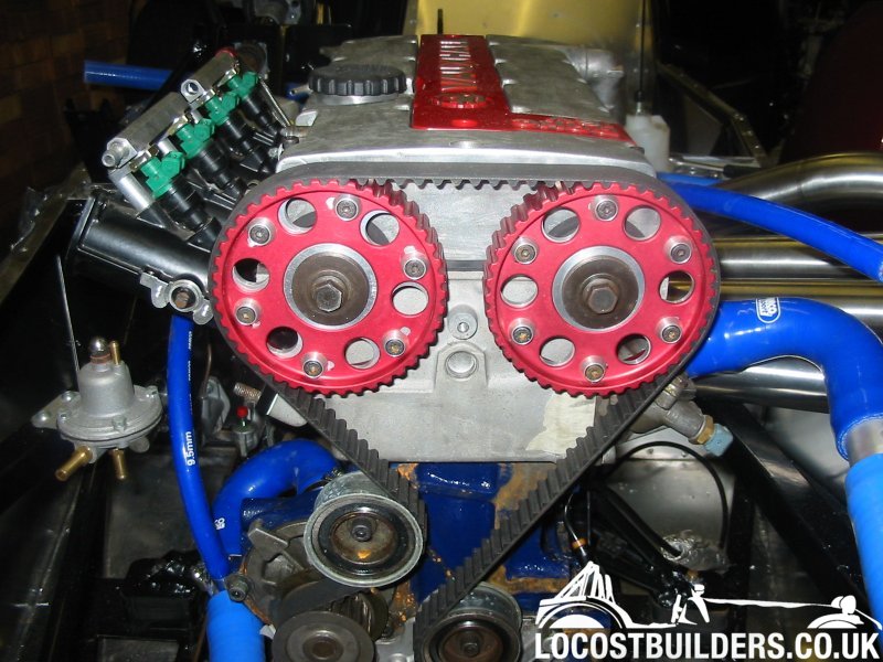

ned
| posted on 4/4/06 at 01:40 PM |
you can see both sensors in this pic of mine: http://www.locostbuilders.co.uk/upload/IMG_1929b.jpg
beware, I've got yellow skin
JJM
| posted on 4/4/06 at 03:18 PM |
Beauty motor Ned-nice one.
