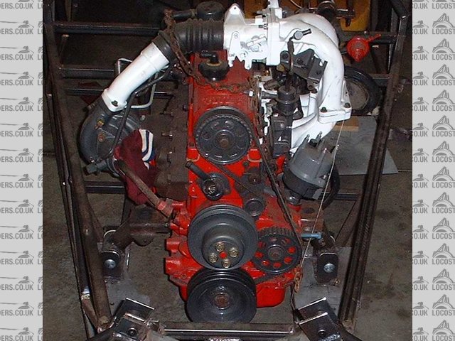

I made very easy and strong ones using suspension arm bushings - 2 to a tube -
strong little movement and failsafe if the bushings fail.

I ordered an engine mount kit from Yukspeed which is very simmilar to Dale's. It's designed for putting an XE into a RWD Escort, but it
comes unassembled so you can chop it to length to suit a locost etc.
