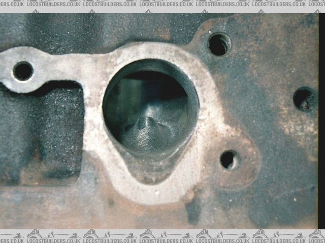

Here is one inlet hole showing the pear shape, (its upside down btw.) it has been flowed but the outer shape is as original. You could just go and buy
an injection gasket to get the hole relationships right. dont use a ford gasket but an aftermarket one they have more spare material.
Peter
