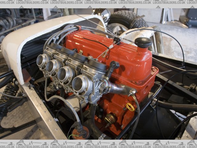

I ordered an R1 conversion a while back for the 2L Pinto I'm currently having built.
I'm currently in the process of painting the car and wanted to check how the R1 carbs will fit under the bonnet so I decided to bolt the kit onto
my 1.6L Pinto to "test fit".
Having fitted them it seemed like a shame not to connect the fuel and see if it would start. Turned the key with just the choke on no throttle and it
fired first time...
After hearing them I just had to rig up a throttle so I could take it for a spin...
The difference has left me speechless.
Where before the engine would knock below 2000RPM and be undrivable I can now floor the throttle at 1200RPM and it pulls like a train all the way up
until I chicken out around 6500RPM.
The car is now totally different to drive.
The £300 I gave Bogg Bros is the best money I have spent on the car. What a result!
Pics plus vids to follow...
Pics:-
  Bike Carbs 1
  Bike Carbs 2
  Bike Carbs 3
  Bike Carbs 4
[Edited on 19/4/06 by andyharding]

The kit from Bogg Bros cost about £305 including delivery. It included the manifold ready fitted with R1 carbs re-jetted to suit a 2L Pinto.
I just disconnected the vacuum advance on the dizzy. No other ignition changes. I may fit an Aldon vacuumless dizzy if needed in the future.
I bolted on the manifold, connected the fuel and coolant hoses, stuck a screwdriver in the choke lever and turned the key. It went first time.
I then bodged the throttle linkage as in the photos so I could take a test drive.
All that's needed is to fit proper throttle and choke cables, fit an air filter and figure out what to do with the crank case breather.
Certainly much easier than fitting twin Webers. I tried that and gave up.

Do you think the fact that the inlets to pistons 1 and 4 is slightly longer than the those to 2 and 3 will have any bad effects? Just wondering
whether it is worth paying the extra for them to space the carbs.
Doesn't worry me at all tbh.
