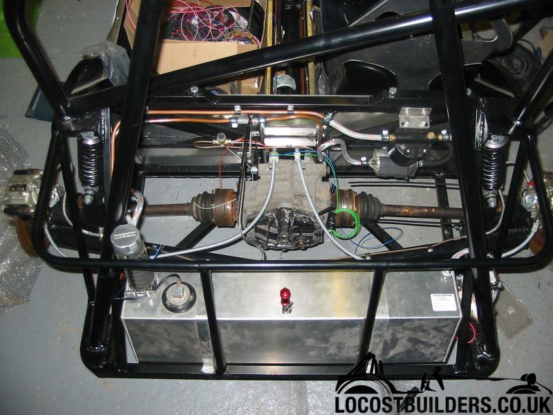

its better mounted lower down as it dosn't have to work as hard lifting the fuel. low pressure can suck better than high pressure pumps can.
heres my setup. low pressure pump is bottom right:
http://www.locostbuilders.co.uk/upload/IMG_1934b.jpg
Ned.
