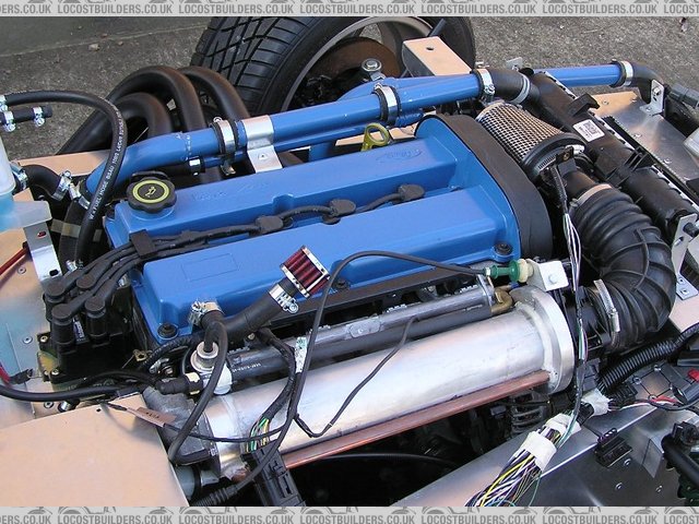

Tuneful inlet
Hmmmm,
I have a problem with my inlet manifold!!!
It is home built, but i get a massive resonance at 3500rpm +. It appears then to act as a musical instrument and plays an trombone type noise, which
can not be reved out of..in fact a closed throttle will stall the engine in this condition.
I think i may have to somehow baffle the inlet plenum...
Seriously, has anyone else heard of or experienced anything like this????

stevec
| posted on 13/5/06 at 05:56 PM |
Simon, Just had a thought have you tried it with the ISCV unplugged/blanked off it may be using the air bypass as a whistle.

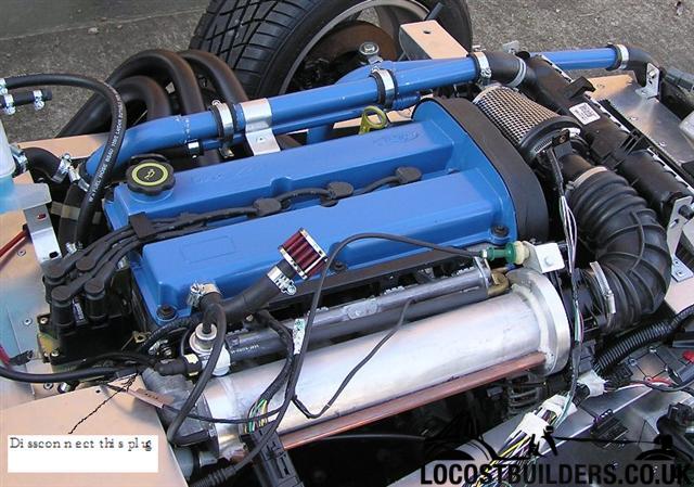

BKLOCO
| posted on 13/5/06 at 08:20 PM |
It's probably the FIdle valve
Mine sounds like a moose on heat
It looks like you are using the Ford PWM one
In the original install they are fitted in such a way that they are muffled
The way we tend to fit them in our installs amplifies the buggers.
I've tried a VW Audi one and a Ford one and they're both as bad.
Hillarious
It only lasts for a short while though Till the cold start fast idle shuts off.
If you remove this plug it should stop it.
This will prove if it is the FIdle valve or not,
[Edited on 13-5-06 by BKLOCO]
By the way.
Your manifold air intake is in the worst possible place
It will be sucking lovely red hot air straight from the radiator.
Definately not good.
To get the most out of your engine you need to get the coolest air possible.
If you can duct it in front of the rad it would be best

diyer
| posted on 20/5/06 at 02:45 PM |
ok, sorted, it was the idle speed control valve causing the noise. So i will have to work on that after SVA!
