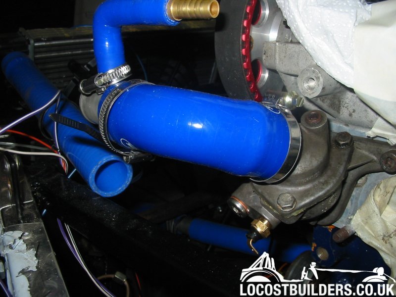

ned
posted on 7/6/06 at 05:48 PM Reply With Quote
yup as already said, one is 1/8npt for your gauge and the larger one is for a bosch sender. i've got a piccie somewhere...
here you go:
http://www.locostbuilders.co.uk/upload/IMG_1977b.jpg
i plugged the bosch sender hole as it fouled the chassis rail and fitted it in the manifold on the inlet side where the water bleed outlet bit could go (not drilled by default on my bodies)
fitted my sensor here instead:
http://www.locostbuilders.co.uk/upload/IMG_1966b.jpg
Ned.

chrsgrain
posted on 7/6/06 at 07:35 PM Reply With Quote
Ah!!
Brilliant guys - thank you - especially the pictures Ned... I'll bang it in there then! Makes everything much easier.
Chris
ned
posted on 7/6/06 at 08:01 PM Reply With Quote
i did know as i had to buy a plug to fit it! m10 or m12 rings a bell. i think i tried the removed sensor on some nuts and took it from there. bought the plug from steves stainless at Detling ealier this year.
