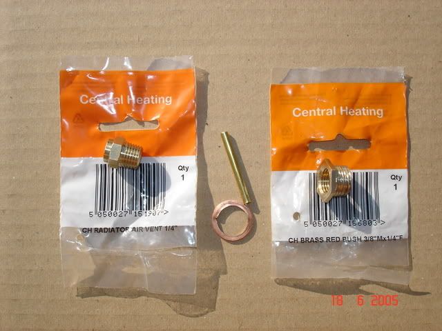

hmmm, I used B&Q plumbing bits and a small brass tube:
to make an adapter, one on the left:

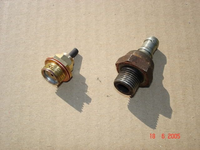

which then fits into the manifold here:
Now the distributor vacuum line goes to the carb - are you saying that I should T into that?
If so, then I'm f**ked ....athough I am pretty sure reading on the web that what I have done is correct, hmm....

As seen in photo; I connected it to the mainfold - an identical port is udes for the servo so I don;t see what difference it would make to T off from the seervo; the guage is maye 50 cm away using a small plastic tube; guessing less then 2 mm I.D.
Re: connection: http://www.iwemalpg.com/Vacuum_gauge.htm
whcih is what I've done. I could try connecting to the carb (distrubutor connection) just to see what difference.
