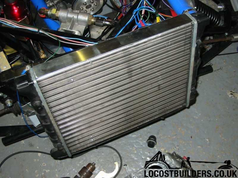

I have an ally polo rad fitted, the type with the fins exposed at the top/bottom for want of a better explanation.
The fins were looking decidely messy where I'd leant over it, stuff had been knocked/dropped against them. The solution is to araldite a strip of aluminium along the top, tidies up the edge and stops further damage to the fins along the top edge.
http://www.locostbuilders.co.uk/upload/aIMG_2468.jpg
http://www.locostbuilders.co.uk/upload/aIMG_2469.jpg
Ned.

Will epoxy be up to the heat ?
ned
posted on 11/7/06 at 09:27 PM Reply With Quote
well a friend has done it on his racecar (where i got the idea) and its still there after numerous races and plenty of heat cycles

'Up to the heat' - Yes, should be no probs. It can only get as hot as the pressurised boiling water, so about 110-115 degrees max.

The Micra rad has a plastic strip on top to prevent exposed fins from getting damaged. Same strip can also be fitted on bottom.

Once again, thank you for the radiator tip. I've fitted the piece and it looks good as well as protecting the rad from further damage.
