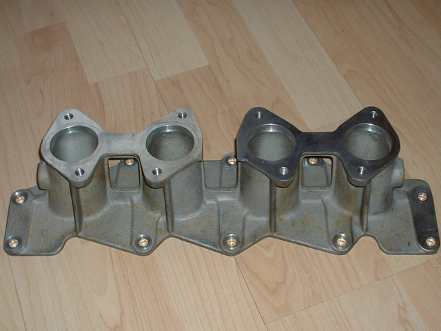

Hi guys,
Im building a zetec powered tiger, im going to run it on bike carbs, i was wondering can I attach the bike carbs onto my Zetec short manifold (pic
attached) this was used to attach dellorto's orginally or do I need a specifically made longer manifold (like boggbro's) to fit bike
carbs?
Many thanks,
Craig
jambo
| posted on 12/7/06 at 07:56 PM |
sorry this is no good you need one like boggs
muzchap
| posted on 12/7/06 at 08:28 PM |
I beg to differ
My mate makes up some adaptor plates that allow you to bolt your Throttlebodies/bikecarbs straight on.
Let me know if you're interested and I'll give you his details.
He's currently using a set on a Pinto with Gixer 750 TB's and a MegaSquirt - goes like a train

mackei23b
| posted on 13/7/06 at 10:26 AM |
Yes, could make an adapter plate

02GF74
| posted on 13/7/06 at 01:15 PM |
you'll need to modify it as I doubt the carbs will bolt straight ont.
Surrey Dave
| posted on 13/7/06 at 04:14 PM |
You can re space the carbs to suit GeoffT did this with his throttle bodies ,on a weber manifold .
you can then make or buy the applicable flange with a short stub on it for them to clamp onto.
Surrey Dave
| posted on 13/7/06 at 04:18 PM |
This is GeoffT's;
