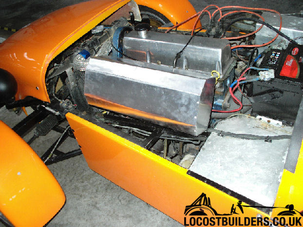

| posted on 14/7/06 at 05:45 PM |
I have a photo of mine in my archive.
I went for a size that allows sufficient static air around the pipercross.
The bit I was unsure of was how big for the feed pipes. I thought about trying to size the ipes to keep a constant steady flow of air to minimise
pulses. In the end I just decided on 3 inch bore so as not to restrict the inlet.
I am not sure if it has helped the power but it certainly isn't any slower since fitting it.

TangoMan
| posted on 20/7/06 at 11:20 PM |
Sorry, I can't see it, can you point me in the right direction or a link?
Ned.
Not sure what happened to it, it was there. Try this one!!
