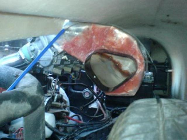

| posted on 26/8/06 at 09:11 AM |
I wish I had that option, its a pig of a job getting it on and off- this picture probably gives an idea of how tight it all is.
  carbs
Ps airbox bolts on!
