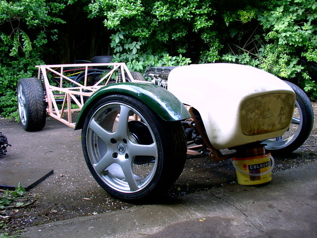

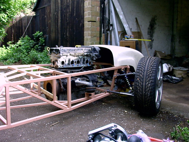

How far does it stick out?
The engine that is!
How high above the top chassis rails does the engine pertrude?
PaulBuz
| posted on 14/5/03 at 05:34 PM |
another view

PaulBuz
| posted on 15/5/03 at 01:10 PM |
The sump has already been shortened by 1.5 inches
the engine protrudes 8.5 inches above the top rails
I just wondered what sort of height the pinto boys have in their cars

That is a Sierra 2.0L DOHC engine
I think it might be OK. After all a Robin Hood 2B will take it, and that's pretty similar in zize.
david walker
| posted on 15/5/03 at 06:09 PM |
I think you have a problem.
You ought to buy/fit a nosecone first and fit it as high as you can. Some people have fitted them an inch higher than for what they were designed.
Then make a scuttle, or at least knock up a cardboard replica and tape it on. When you have done that offer a straight edge between the two and see if
you are OK.
As I say I think you may have a problem, but it's not one you can't get over, but don't make the engine installation permanent yet,
get some bodywork in place.
The R/Hood is bigger, taller and wider than a book Locost - which your chassis looks to be.

PaulBuz
| posted on 15/5/03 at 06:29 PM |
Like this

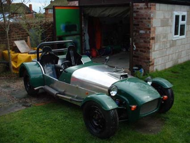

| posted on 17/5/03 at 12:24 PM |
engine position
If the engine is a similar height to the pinto 2ltr and you can get it well back in the chassis you might not need to modify much to get it under the
bonnet if your nosecone is higher than a standard one. I cut my bonnet and put a lump on top to cover the cam case and a hole for the carb to stick
out and it's only about 2.5 inches high. A bit bodgy but when everything else is done you don't want to alter too much.
yours, Pete.
