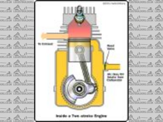

this is gasoline two stroke
Kamikza
| posted on 9/11/06 at 04:43 PM |
and this two stroke diesel wher can i get the pump can i use the pump that sprays water on the windsheld?? and how to put it
NS Dev
| posted on 9/11/06 at 04:56 PM |
you won't burn diesel in it, simple fact it will self destruct at the compression ratio required....
however, you could (not that you would want to!!!) burn alcohol/nitro mix in it with no spark plug if you raised the compression a bit and put a
decompressor screw on it plus a blowtorch on the head when starting..............
WHY?????????
